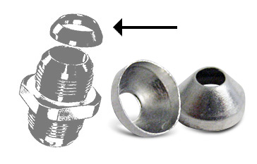

No. Only on tapered, NPT threads. The AN side with the 37 degree angle seals dry on the 37 degree face. If the faces are slightly mared and cannot be easly replaced, there are ̶t̶e̶f̶l̶o̶n̶ Aluminum tapered washers you can install in between.
EDIT: The washer are Aluminum

Originally Posted by G-force View Post
No. Only on tapered, NPT threads. The AN side with the 37 degree angle seals dry on the 37 degree face. If the faces are slightly mared and cannot be easly replaced, there are teflon tapered washers you can install inbetween.
No, not tapered teflon washers.
They are formed soft aluminum seals and should be able to repair marred surfaces on the 37 degree angle faces.
https://www.aircraftspruce.com/catal...37fittings.php
I stand corrected, its been decades since I actually had on in hand. It appears Del makes them in Aluminum, copper, nickle and stainless.
