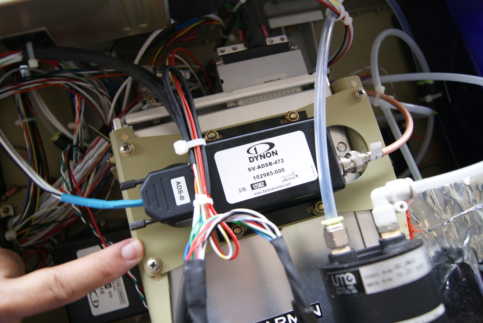

As mentioned by others, to make the install easier you will want the new mounting bracket. The new bracket uses the same mounting locations above the radio that were used to mount the 470 unit. Below is a photo of a completed instillation ... my finger is pointing to the new bracket. Note how much smaller the 472 unit really is .... actually not a whole lot bigger than the DB connector.

Thanks John. Parts should be here tomorrow and you pic makes the installation process easy to understand............Tom
