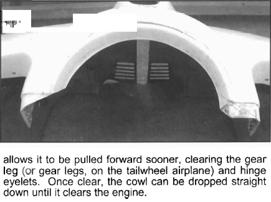

Originally Posted by LifeofReiley View Post
Steve,
The article is in the 4th issue of 2007. page 15
Unfortunately RVator 2007 and later issues are not included in 27 Years of the RVator and this link to past issues on Van's website is currently broken: https://shop.vansaircraft.com/public/RVator.htm
Does anyone have the PDF file of that issue or can post the picture of how to cut the lower cowl to make it easier to remove?

As requested from this other thread...

Default RV-4
On the RV-4 it looks like I may be able to cut a larger opening for the gear sockets/legs, pull the rear side hinges out to clear the fuselage sides, slide the cowl back and then down and out. So, between the diagonal cut at the front and bigger gear leg openings at the rear, it looks like the lower cowl can be fit pretty tight to the spinner too.
The top cowl should lift straight up after bending the lower rear part of the cowl out to the sides (clearing lower sections of firewall hinges). Of course this requires that hinges are offset enough that they will clear the lower cowling side and top forward skin (Section P-P on Drawing #43).
Finn
