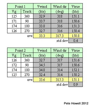

Finished the annual over Christmas and just now had the chance get out for some testing. 875 hr on the plane. RV-9A, O-320, Carb, Dual P-Mags, Hartzell
Conditions: Temp -9C, Altimeter 30.11, 8000ft, MP 22.1 in, 2260 RPM,
1/4 Carb Heat
She is holding right in there - about 151 KTAS on 6GPH, and still a hoot to fly.

The link to the spreadsheet your using is now broken Pete. I know that post was a few years ago but is there any way of getting another copy of the spreadsheet your using? I could help out here and include a link on my website to make this sheet available to VAF if you send me a blank copy of the sheet.

Take a look at the site: http://www.ntps.edu/ . Once there, look at the "information" tab, and select downloads. You will find both the word document explaining the procedure, and the excel spreadsheet.

Here is: http://www.ntps.edu/images/stories/d...ts/gps-pec.XLS

Hi Guys,
Here is the annual update - the old girl has a 1000 HRS and 6 yrs under her belt.
She has not lost a step according the PEC 4way GPS Spreadsheet - actually picked up a knot!!. We tested at 8000ft/8370ft Density, 0degC, with Otto the pilot holding altitude and GPS ground track. Engine was set to LOP at 6.0 GPH and 2270 RPM. Here are the stats:
29 statute MPG at 175 mph. I still love this plane!
Nice high clouds above and frozen lakes below.....
Almost got her to hover in the wind!
