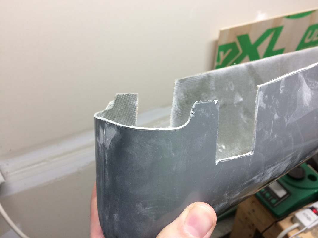

Default 12-02 Rudder bottom Fairing
Page 12-02 Step 2 states "Drill #30 two holes on each side of the R-911 Rudder Bottom Fairing as shown in Figure 2. Take care to keep the holes
within the area defined by the scribe line. Remove the area up to the scribe line on the rudder bottom fairing as shown in Figure 2".
Pay attention to figure 2 as it shows a straight cut along the top of the fiberglass within the scribe line. DO NOT FOLLOW THE SCRIBE LINE AROUND THE FRONT OF THE RUDDER FAIRING. If you do so then you will end up with a funky looking fairing and realize you just screwed up.
I think once you finish the rudder , you will find that you would not be able to install it on the vertical stabilizer if it didn't have that funky shape.....

Default 12-02
I went back out and fit the fiberglass to the rudder and the cutout in front actually fits pretty nice. I had to clean up the edges a bit since the scribe line was not equal on each side and the front area had a distinct slant, but once trimmed significantly and fitted to my rudder it looks a bit better.
Lets change this plan gotcha to:
"be weary of the scribe lines symmetry and ensure you cut short before trimming to the specific fit of your rudder. Figure 2 does not match the scribe line on the R-911 Rudder fairing."
I'll add some Flox to fill the gap in front of the rudder horn once the temperatures here warm up a bit.
