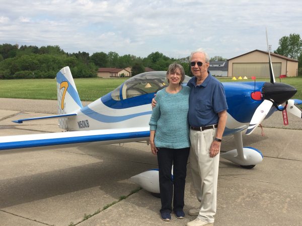

Dolly and I traveled to Lakeland for three days of reassembly. Vinyl N number, wing walk material and other decals were yet to be applied. I left Florida four days after "Dream Weaver" left the paint shop. 6 Hrs 38 min flight time to mid Michigan with one fuel stop. What a plane! We are very happy with it.

gorgeous!
Thanks for sharing the story

Looks good. I like it!

Awesome paint job! I hope to get mine done this fall/winter as well.
