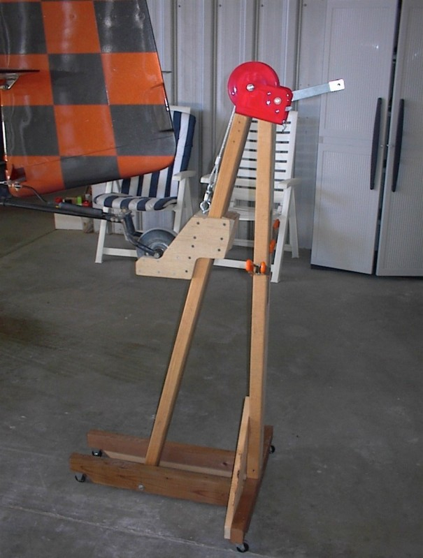

I have a Tail-Mate as well. It is very stable, no flexing at all. Robust locking mechanism, but still put something underneath, of course. Sounds like a business opportunity for Alan Nimmo of AntiSplatAero.com!
A few years ago someone on the forum built one of wood, but the pics are gone now.
Carl N.
Arlington, WA (KAWO)
RV-8, 320 Tach Hours
(Pic 1),(Pic 2)
(Pic)

Not mine, I just happened to save the photo.

If someone would send me some pictures of the Tail mate I would make them .
