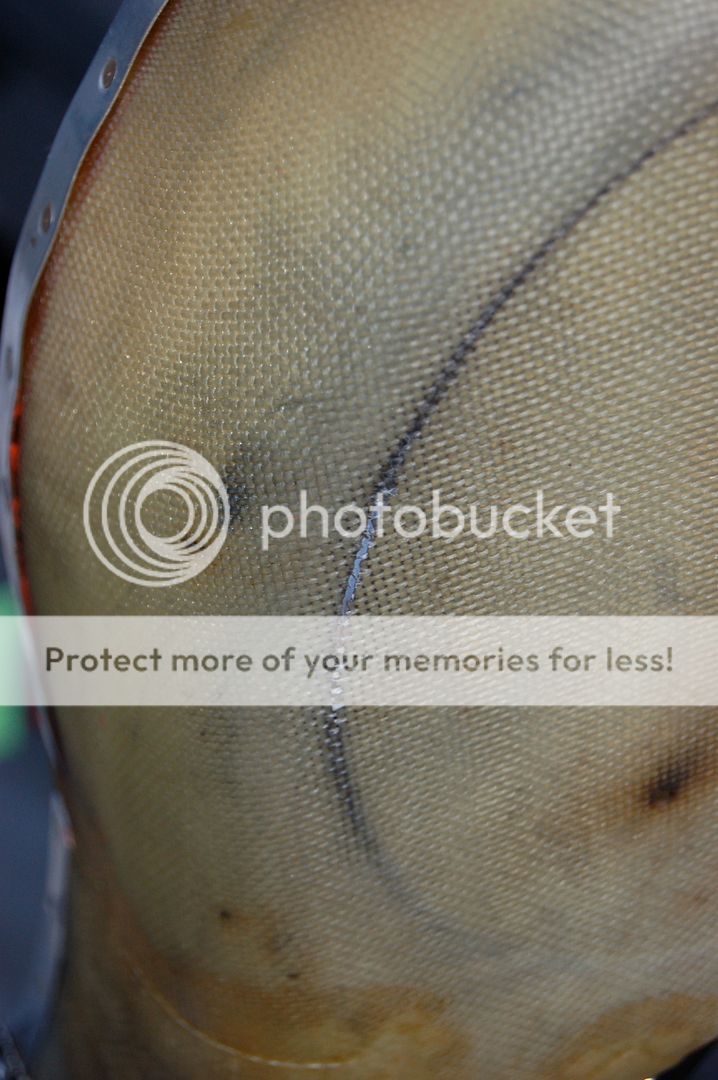

Because of this post I've kept an eye on my filter, here it is after 31 hours on the tach. I really can't believe it shrunk that much, you can see the sharpie marks of the original diameter on the FAB.
A phone call to K&N followed by an email with pics and a description of purchase date, time in use etc netted me a new filter in the mail.
I'm curious if it's the filter or the installation/Fab that is making it shrink.

Because of this post I've kept an eye on my filter, here it is after 31 hours on the tach. I'm curious if it's the filter or the installation/Fab that is making it shrink.
Did you install FAB drain tube?
I am wondering if those like me that installed the aluminum piece on the inside, which causes a little more clamping force on filter are having this problem?
Also what are your normal cruise altitudes? This filter is marginally sized for a 360 cu in at 2700 rpm, let alone my 540. If you fly low/high MP/high RPM a lot, you might be creating a higher pressure differential. I rarely fly low and rarely at high power settings due to birds(live and man-made).
Mine is exactly the same size after 135 hrs 2.5 yrs.
