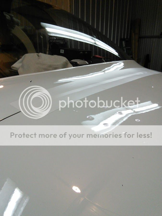

I've had some rain where the engine developed a slight non-uniform miss, I pulled the carb heat closed and it cleared. Pulling the carb heat in heavy rain may be beneficial. I have limited testing for heavy rain.
but this tape helps keep water out. doesn't need to be this wide in the aircraft axial direction. extends slightly beyond the hinges.
