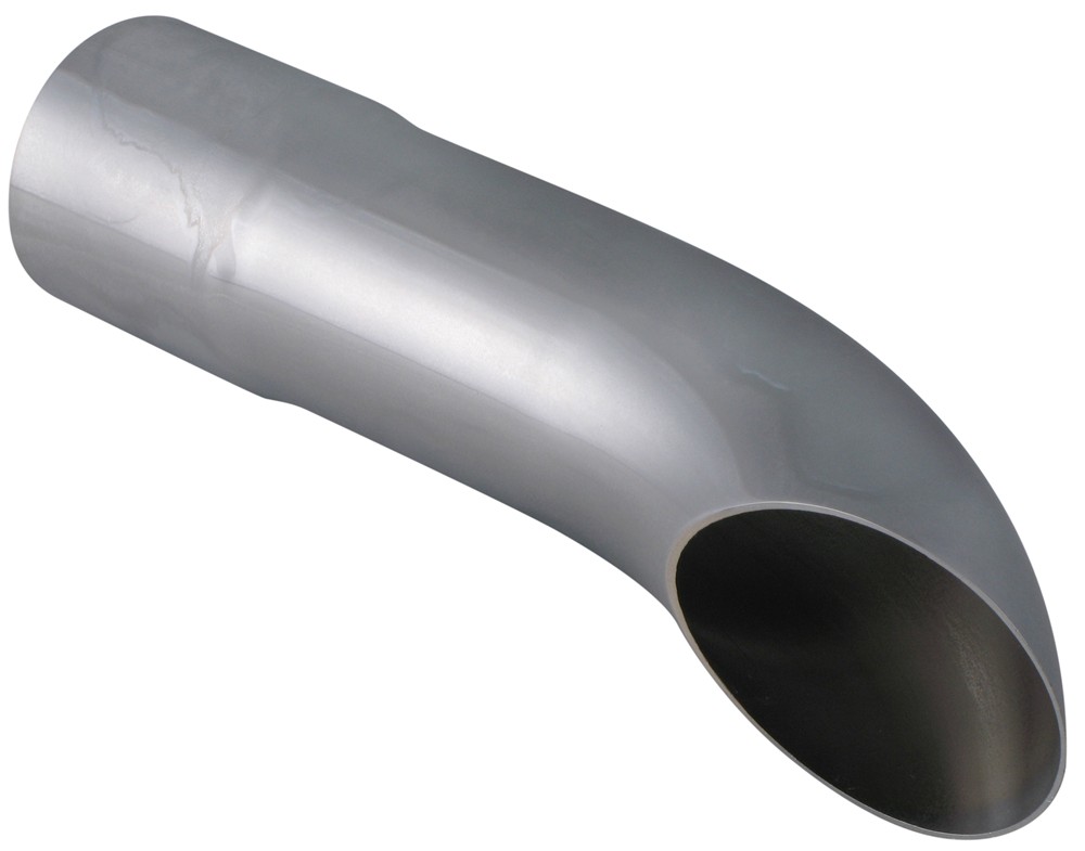

A downturn really helps. I built a 4-1 for an airplane which originally had a muffler right at the collector - it was still loud. Ultimately the muffler was replaced with a slash cut downturned tip and that was more effective at cockpit sound reduction (and a LOT lighter).
I purchased my exhaust from Vetterman and asked to purchase the "optional turn downs" and was told they would fabricate the exhaust for me with them already built in. I said ok and asked how much extra? Was told they would include them in the price quoted.
Yes the 22-1/2 degree turn downs makes a big difference in the amount of vibration one feels on the floor and the noise in the cockpit.

Can the standard Vetterman pipes be cut at an angle close to parallel to the fuse floor to come close to the turn down effect? I'd rather not add weight or parts. Does anyone have experience with this?
