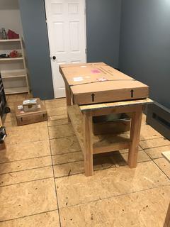

Finally got around to getting a picture host.
The boxes
After a couple days bench building and organizing it is time to open the box
And about two hours later I had one of these
After a few days at work I came back to the hangar. I learned a few things making this half and the other half went together in no time. Many thanks to those of you who offered suggestions and answered my many questions.
