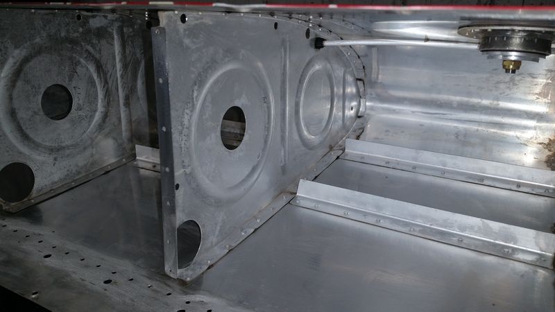

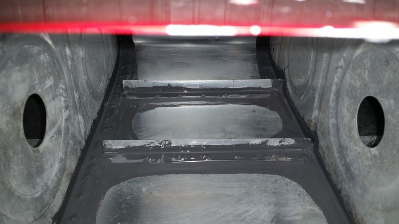

Default cleaned
and sealed....

Thumbs up Wrap up..
So the tanks have been installed and I have had full fuel for almost a month now. Also about 10 hours of flying... All good. No leaks.
Very impressed with Paul's cleaning, very smooth and clean.
One thing to be ware of. He removes the rivets (top and bottom) that secure the rear wall of the tank and then after cleaning, replaces them. Consequently the paint along this row of rivets is touched up and of course, not like new.
Small price to pay for clean, tight tanks. Cheers
