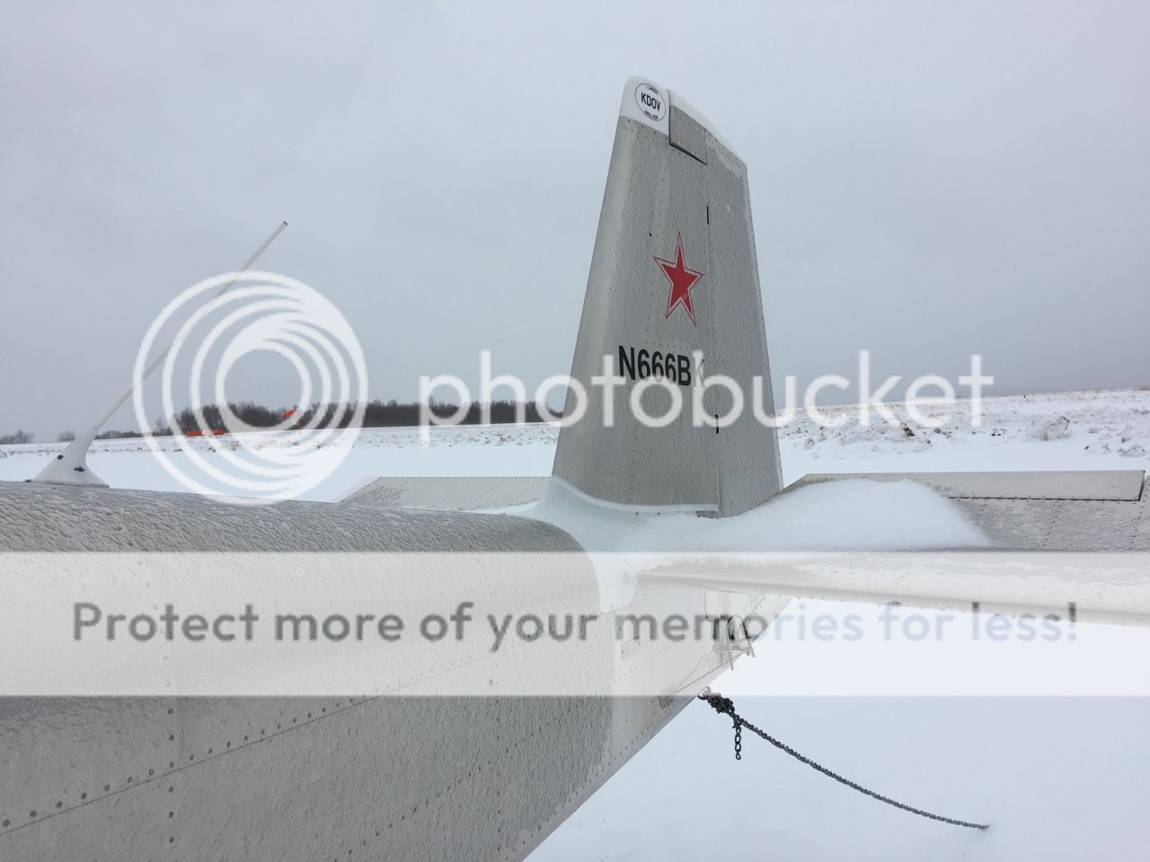

Posts: 7,688
Todd since you are tied down in Florida your ropes won't freeze so you don't need chains. As was already mentioned the ropes must be tight and knots should be secure. Control surfaces have to be locked with special attention to the rudder. Nearly three years I am parked under the elements and winds at my parking spot are 80% quartering tail. I lock the controls from inside and out. Remember the Florida birds eject very toxic poop if you have a clear coat it could be ruined on the rudder. Birds can also build a nest if you don't fly often. You have to close the space between exhaust pipes. I hope you get a hangar soon. Fancy Bruce cover would last you about three years then you need to shell mnogo roubles for another one.
