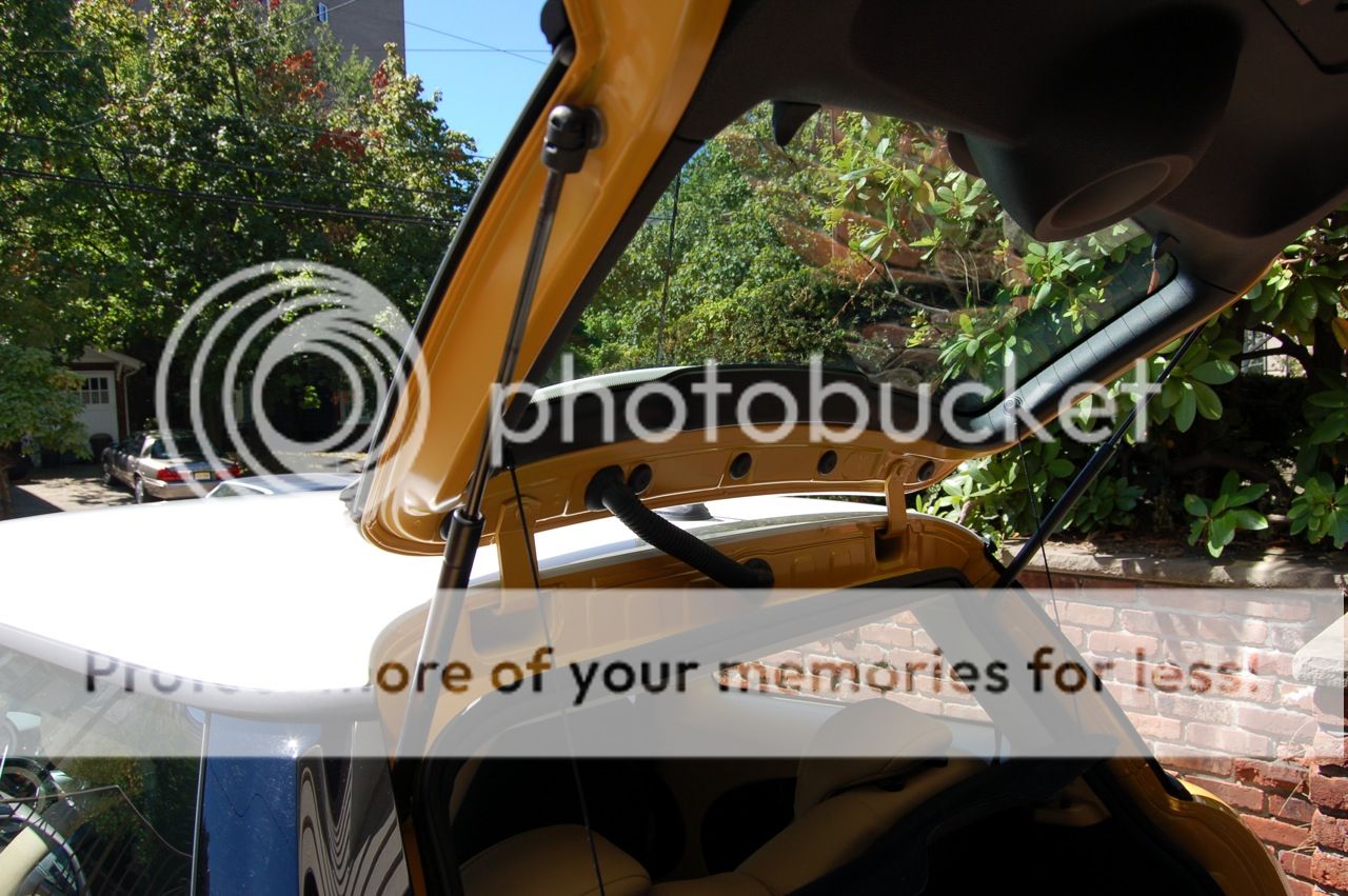

I was very surprised to find out that struts on my Mini are exactly the same Now I have a pair of donor struts for free.
