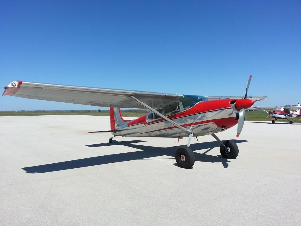

Originally Posted by Buggsy2 View Post
Couple of photos of nice paint/polish combinations. Sorry, I don't know who these belong to so can't give proper credit.
Love the paint/polished aluminum combo - but how the heck do you polish bare aluminum up next to the paint line?? Mask off the painted parts before polishing? That's a lot of masking!
