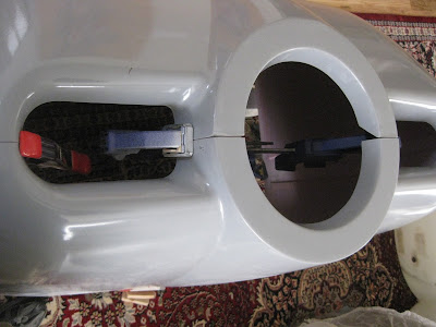

On page 45-05, fig 1, the exploded view shows an inside corner line that calls for an angle that doesn't make sense to me.
I'm looking for some clarity, as this cut would seem to result in a triangle opening in the cowl and omitting it will have both cowls mate evenly.
Confused.
Edit: I found this pic (not mine, it's on E's site). This is correct? Is there an obvious reason for the triangle cut-out I'm missing? Stress relief perhaps?

Think of the spinner being in place.
To get the lower cowl off it has to be lowered below the spinner.
The trimmed off areas are the last interference that would exist between the spinner and cowl... if they weren't removed.

Ahh! Okay, got it. Thanks, Scott!
Looks like you jumped the gun on posting "All kits done"
I would have thought the outside portion will be touching the spinner back plate or spinner but not the inside. I am not there yet with my build, way to go, but I am also having difficulty visioning this.
