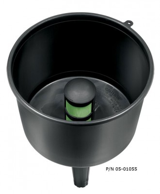

Originally Posted by Sam Buchanan View Post
There are good reasons why mogas is recommended by the manufacturer for the Rotax engines. I've used mogas off and on in the RV-6 for over 15 years and ALWAYS use a Mr. Funnel when transferring mogas from the 5-gal can to the wing tanks. This funnel has a filter so fine it will capture water molecules and eliminates the possibility of contamination from the fuel can.
Highly recommended for our RV-12 pilots even though some ingenuity will be needed to adapt it to the RV-12 fuel filler.
https://www.aircraftspruce.com/catal.../fwfunnels.php
I use a dual filter version on that funnel, I never put fuel in my RV's wings unless it's thru my funnel, peace of mind even though it's a pain and I get odd looks when fuelling!
