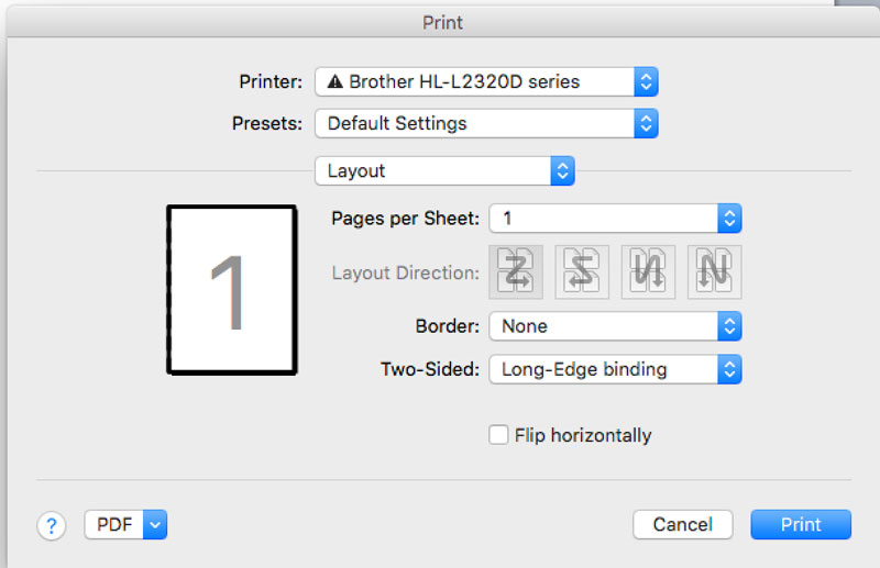

Bill,
Here's the settings page for the Two-Sided printing. I think that's what you are looking for.
Word -> File -> Print... > Copies and Pages dropdown to Layout.

Originally Posted by Lenny Iszak View Post
Bill,
Lenny, that is indeed the setting I wanted for the correct 2-sided printing, but between WIN10, word 2011, and my brother HL2270 printer, those options are not available, BUT I do have a measure of success.
Without all the 50 pages of experiments, here is the inelegant workaround.
Using the Repuchi POH file, I printed using cutepdf and settings of 1 page, scaled to letter size. [note:Booklets etc dont work here.] Then, opening tat pdf print file in Adobe Acrobat (free version) the print option does have the booklet option, binding direction, and duplex rotation edge. That printed two pages on one letter size, and put the correct pages in the correct order for folding and stapling for a left side binding. Yaaa - now is time to do the actual content.
