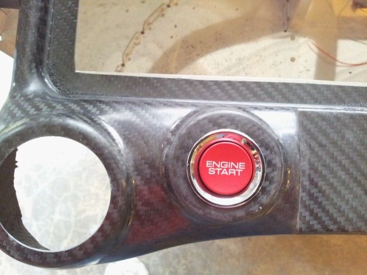

FYI, this is what it looks like inserted into the panel - just not secured yet.

Charlie could your show the back of the knob please?

Can you find some tubing (PVC, thick wall AL, etc) with the right diameter? If so, just cut to the right length & slide it on the back after inserting the switch in the panel.

It's a possibility. The back as for "ears" at 90 degree intervals that can be used to keep it from rotating, so if I can't find a pipe, I might have TAP plastics make up a plastic insert/bushing to slide it into.
