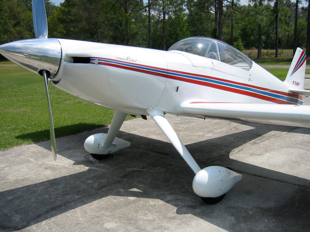

Originally Posted by maniago View Post
In one of these big tires thread around here someone mentioned the Sam James 5x500 wheel pants, but I cant find it anymore.
So anyone using James pants with the 380s? Looking for any lessons learned and maybe some pics.....I'm at the pants buying stage.
Thanks for any help.
Mani,
My HR2 had Sam James Pants on it when I bought it. When I converted to Rocket to the 380's, I attempted to retrofit and modify the SJ pants but they were too narrow, shallow and would have looked goofy jacked up above the bigger tires and defeat the purpose of drag reduction.
Additionally, the SJ pants are longer with no up-slope aft of the tire which reduces ground clearance on rough turf, gravel or mud, especially with the HR's high AOA when parked.
After much measuring, cutting and staring at Steve Sampson's blog, I purchased and installed the Van's Pressure Recovery pants.
They work well, are easily cut and fair around the tires nicely (see pic).
Post script: I didn't lose one knot of speed with the bigger tires and Van's pants
V/R
Smokey
screen shots
Van's PR Pants have plenty of room.
My HR2 with the 380's installed
PS:If you operate off rough turf or gravel, fabricate Thin chrome molysteel wheel pant brackets using the aluminum examples as a guide, much stronger.

Posts: 2,010
I put 380ís on my HRII with the Sam James pants, but itwas too tight of a fit. In the end I used Desser retreads which are the same diameter as the 380s, but narrower.

Originally Posted by vlittle View Post
I put 380’s on my HRII with the Sam James pants, but itwas too tight of a fit. In the end I used Desser retreads which are the same diameter as the 380s, but narrower.
Vern, glad the RT's and your James pants worked, but my whole reason (and anyone else) for installing 380's is the wider footprint on soft ground. Reason is, they work. They also improve handling on hard surfaces...
On my soft, sandy turf strip (especially after a good rain) the difference in taxiing (or sinking) and landing (and not flipping over) my RV's from 500's to the 380's was very noticeable. However, on the heavier HR2, critical.
If you venture off road in an RV or Rocket, these are the tires of choice IMHO, AK Bushwheels notwithstanding.
Something to consider on yours...
V/R
Smokey
V/R
Smokey
That was my original purpose with the 380s as well. Unfortunately, the James pants are just too tight of a fit. Everything was fine until I reversed the tires on the rims, then they interfered.
FYI, I found that it's the wheel pants, not the tires, that are the limitation on soft fields. I have come to the conclusion that the Rocket is not a bush plane, go figure.
