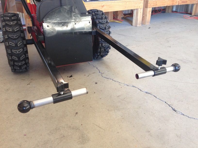

I couldn't find the blower in the local stores - we don't get much snow. Most of the online ones are too spendy or unavailable. So I found the same blower as the OP via Craigslist. Works great and I was able to pick it up for $250. So I will be performing some surgery on it since the plane is in the paint shop. Thanks for the great tip!

Thanks again for the idea. I was able to find an identical model on Craigslist for only $250. It was used for one season. A little iron square tube and rod, a trip to the local brake shop for some welding, black spray paint and some handles from the local hardware store and voila.
