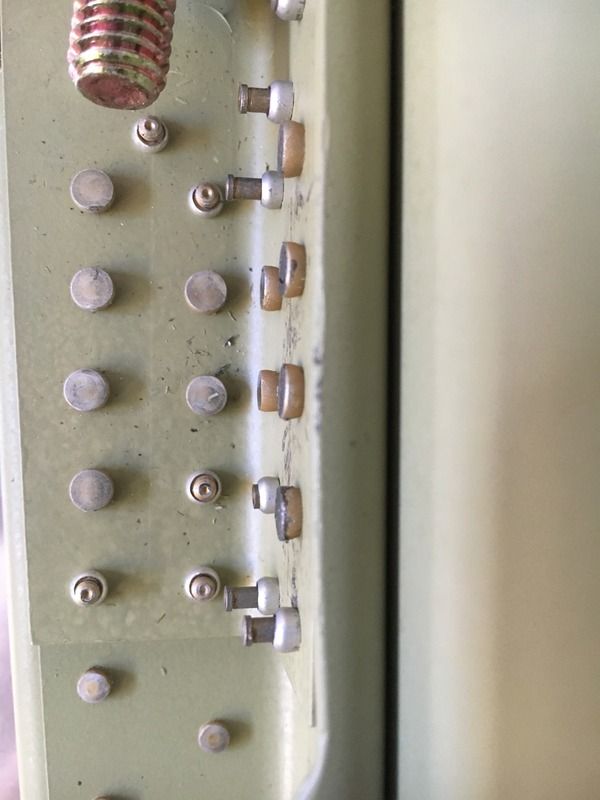

I noticed that the set side (the inside part) were not all uniform in their set depth. I then looked up the cherrymaj spec sheet:
http://www.cherryaerospace.com/docs/...gs/CA-1011.pdf
I may have also found something else. But on page 18 is shows what they should look like. A lot of mine 25 % were not set completely so that the safety lock was engaged. I drill out and they were super simple to get out. I assume that if they had been set correctly, then the removal process would have been more difficult. I could be wrong.
I might have taken pics. If so I will post later.
I used a pneumatic puller to set. But not one made specifically for cherrymax.

Here are 3 pics, they can be enlarged by clicking on one:
https://magnusrv.blogspot.se/2017/12...ttachment.html

Hopefully the picture uploads

Originally Posted by Stockmanreef View Post
It is the ones that you can't see the inside so you will never know.
The document you previously linked too, and Section 5 in the construction manual have details that explain that a properly set Cherry rivet will have the broken stem flush, or very nearly so, to the top of the manufactured head of the rivet.
