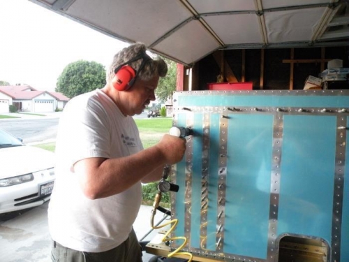

Default Regulator
I use one of those cheap HF flow valves on my rivet gun. I keep my compressor regulator on 80 psi and I have a mark on the the HF valve for -3 and -4 rivets. This combo produces very good repeatable rivets for me. And this beats going back and forth resetting the regulator on the compressor.

A small lightweight regulator is your friend. Mine stays with my rivet gun. Quickly and easily adjustable as rivet diameter and/or lengths change. Saves lots of trips to the compressor to adjust the main one, and, even better, saves you from accidently smashing the krap out of a #3 rivet with 90 psi.
