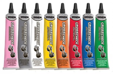

I pickup up some of the CrossCheck at SnF. Seems much better than TorqueSeal. Foil tube instead of plastic. The TorqueSeal brand has always dried out very quickly for me, sometimes before I can even use it.
