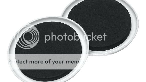

A pair of larger moving pads and two tie wraps will save you nearly a tank of gas.

Kyle I used this type of furniture pads as aileron locks. Drilled two holes in a pair and zipped together with tiewrap.

Makes sense. I read your original post as indicating that system could secure the control systems for rudder, ailerons, and elevator. I couldn't make that work in my mind...
