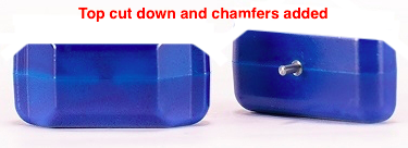

The Marvel Schebler floats apparently are heavier than the 7 gram Rotax spec and will most likely cause fuel level to be high in the float bowl.
I have an idea to fix this. Marvel Schebler says their epoxy floats can be cut and punctured and still function as designed with no fuel saturation into the base epoxy material.
Bing designed the float to be symmetrical so that it can be installed without regard to orientation.
My idea is to remove some of the base material on the MS float to attain <7 gram weight. Either machine off some of the top of the float to reduce height and/or machine chamfered edges on the top side of the float. Either method will reduce weight, and if as MS says, the epoxy will remain sealed to fuel impregnation. With this modification the float will no longer be symmetrical and will require correct orientation during assembly.
I have sent this suggestion to Marvel Schebler and we’ll see if they respond. In the mean time, I’d like to get hold of a pair of MS floats and experiment with material removal to get weight under control.
Below are pics of original MS floats and floats modified for height/weight.
