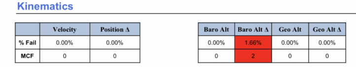

I’m having a low-level Baro Alt problem with my uAvionix ADS-B installation. Most PAPR’s are good but some come back with close to 2% Baro Alt error and are marked red for failure. I talked with FAA ADS-B folks at Oshkosh last week and they said problem is intermittent with my altitude encoder reporting. So maybe encoder is bad or wiring problem. See post http://www.vansairforce.com/communit...2&postcount=21

9500' was as high aa I flew and that was max on flight's PAPR: Baro Alt (ft): 400 - 9500

Yes, I'm familiar with threshold monitor. I tried for several months to fine tune this setting with some good / some bad PAPR and finally decided to hard wire the transponder with uAvionix supplied MUX cable. So now I get a low incidence of Baro Alt failure. About one out of ten flights gets a red box on PAPR.
As a side note, I talked with FAA ADS-B specialist at Oshkosh last week and he said I should continue to try to fix the problem but FAA would not reprimand me if the problem doesn't get fixed. He said they consider this a low level problem.
