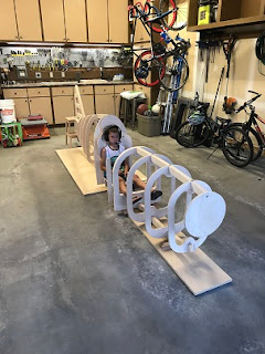

Default Getting the scale just right
The only way I can ensure that the scale is correct was to get a profile view of the target audience. Fortunately my two kids are ages 6 and 9 so this works perfect. I had them pose in a sitting position and then took pictures. I was then able to transfer their outlines into AutoCAD and then I can begin the task of drawing the aircraft around them. This allowed me to get the size right, they can fit in the plane and yup! The plane was big enough to make it impressive!! 13' long and a wingspan of 16'. Little did I realize at the time just how big this was!
Now that we had the design. I used the printer at work to plot all of the various pieces on paper. Using an old technique for painting, I used a ponce wheel to trace all of the outlines of the pieces and used black chalk to trace nearly all of the pieces onto plywood. (Baltic birch to be exact). Fortunately I had lots of help from everyone at the Edmonton Home-built Aircraft Association and EAA Chapter 30. Lots and lots of hours when into cutting all of the pieces and shaping them. We didn't have access to a CNC machine, so we did everything with band saws, drill presses, routers and sanders. I was really impressed at how excited everyone was to be part of the project.

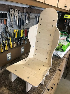

Default Building a wood seat
It was always stuck in my head that I wanted a cool cockpit. I wanted the cockpit to be as much like the real thing as I could. Why? Tell me that you don't love looking at the RV interior pictures! Everyone is always peaking inside the cockpit. At first I though about buying a wooden kids chair. I searched IKEA, then Amazon, Lowes, Home Depot. Nothing. I was forced to build my own seat. So I went to work, I was going to make it simple at first. But as I rolled into the construction. I just didn't impress. So I went to work. Cutting, sanding, cutting, trowing away pieces and cutting. By the end of it my kids were so annoyed with me because I kept asking them to sit in it so I could measure and check fit. In the end, I was pretty happy with how it turned out. Do you think Classic Aero would cover it?

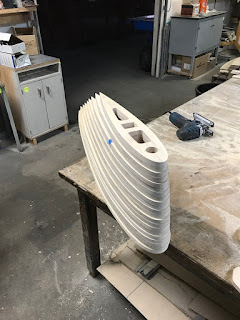

Default Assembling the Fuselage
Assembly of the fuselage was so much fun, but took an incredible amount of work. Its funny how things just slap together in your mind, but in real life - Not the case. Lots of painstaking work and measurements and router jigs were put into good use. I used very long strips of Douglas fir as stringers, clamping them to the sides of the bulkheads and marking locations. The amount of time taken to router all the pieces and get fitment anywhere near the Vans Kit took an unbelievable amount of time. (Really makes me appreciate my RV7A kit even more). I should make a special mention that I designed the entire plane with furniture style hardware so that the entire plane can be assembled and disassembled for transport. A special mention and thanks to my wife as I kicked her van out of the garage for the summer to make some room for the plane.

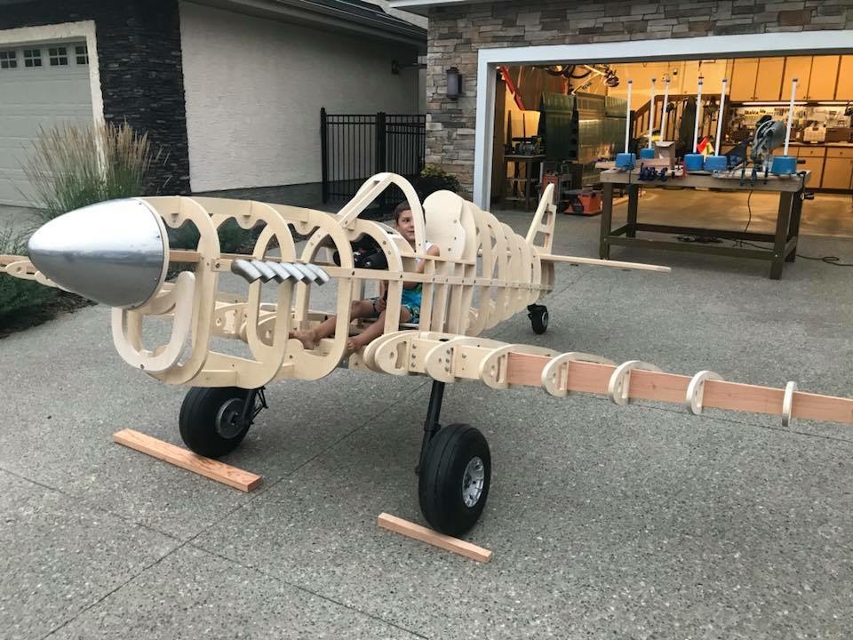

Default 90% there 90% to go
I reach a point where things where build up to what I had designed. Now i was into prototype fabrication. I was extremely difficult to figure out how to build the forward and rear spars. I needed the geometry to work and also allow me to easily remove the wings. Ive never spent so much time measuring and using laser levels. Did I mention the amount of slivers yet??? Took me a couple of weeks and a couple of tries but I finally figured out how to build the spar bulkheads.
The only part that I hadn't done any work or design on was the main landing gear. I knew that I had to attach the gear to the main spar and try to keep the stance as wide as I could to ensure stability. I had toyed with the idea of using wheel barrow wheels as the main gear, or even garden tractor wheels. At this point the EHAA/EAA club found some landing gear off an old homebuilt aircraft that I could use. I was having quite a time making the gear work. About four tries with different materials over three weeks. I even had to consult with a structural engineer to deal with the torsional stresses that the raked gear presented. I wanted to be sure that aircraft was strong enough to have mom and dad stand on the wings when little Johnny sat in the plane.

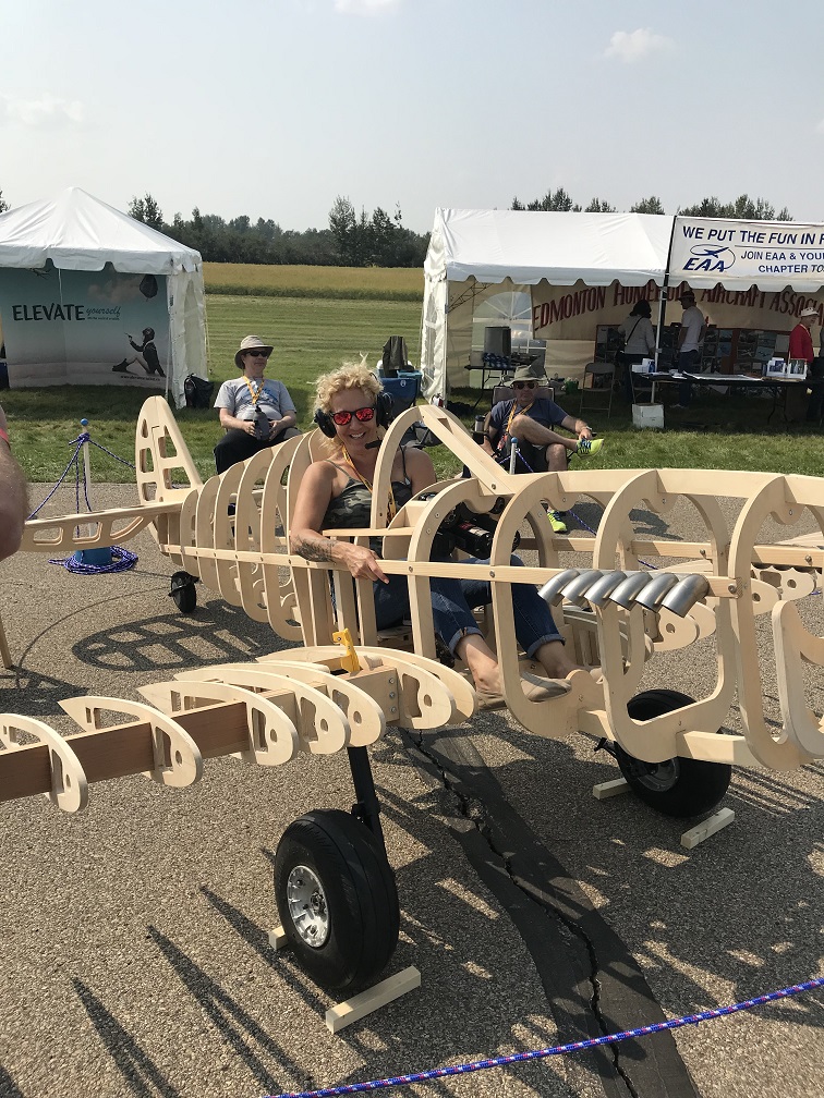

Default The final touches
Once the plane was more to its final form, the creativity flowed from everyone. PVC pipe for the exhaust was quickly replaced with stainless steel tips. Ducey Avionics was happy to supply some dead instruments for use in the cockpit.
https://youtu.be/D_qzbKhm1Mo
I really think it was a cool project. I hope you think so too!
