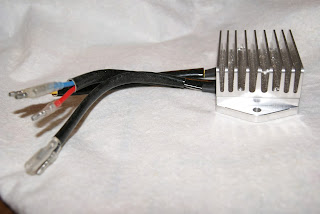

Jim - I can't speak for the JD regulator ... don't know about its specifications. However, I can state the Silent Hektik is rated for 47 amps at 14 volts and that means it will not be hanging on the ragged edge of failure while in use in the RV-12. I purchased the unit about a year ago and believe it was somewhere around $180 plus a little for shipping.
Below are a couple of photos of the unit ... you can tell just by looking it is designed to dissipate some heat.
John

Ed - Sadly, I can't give you an update on how well the regulator performs because I have not installed the regulator yet. I was planning on installing it prior to the airworthiness inspection but ran out of time, so just temporarily threw in the Ducati regulator ... didn't even place the wires in the connector block because I knew it would not be a permanent install. I plan on installing the Silent Hektik unit between now and Spring thaw and keep the Ducati as a backup.
At this point in time I make sure the battery is charged prior to engine starts so the load on the Ducati regulator is as minimal as it can be, without the need to charge up the battery on top of supplying the avionics and lighting power.
Hopefully Jetguy can chime in and give us a performance review ... he should have more than a year on the Silent Hektik unit by now.
