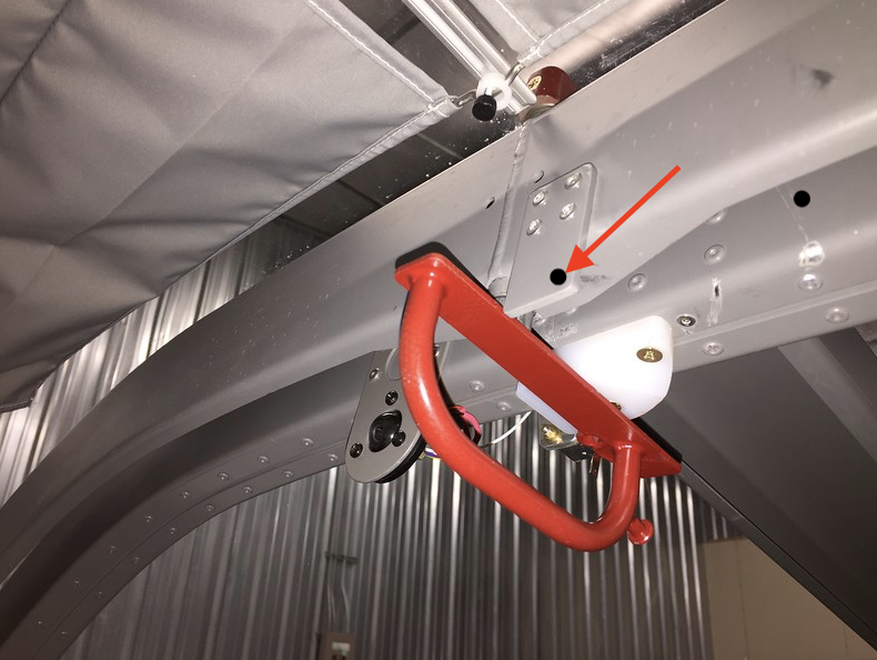

As long as we're at it... Here’s a suggestion to keep the latch handle oriented in the open position when the canopy is raised/lowered. Drill a small hole and press in a nickel-plated Neodymium magnet (3/16”∅ x 3/16”) it will hold the steel handle against the stop plate. When lowering the canopy while standing outside of the airplane the handle will often rotate and strike the roll bar preventing the full canopy closure. You then have to climb up on the wing and turn the handle by hand. The magnet fixes this problem…

The magnet would work but I am a little hesitant to place a magnetic source that close to the magnetometer, in case of the D-180, or the ADAHRS, in case of SV, located a few feet away in the tail cone. It might not be a problem, but the KAI instructions to simply squeeze the tube the handle turns in works well and why deviate from the plans in this regard?
I use a vise grip to do the squeeze, that way you can just barely turn the adjusting screw and do a trial squeeze without over doing it. It is easy to over squeeze and then have a problem getting the handle back in.
