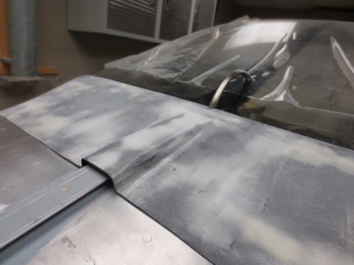

I used one layer of fiberglass and two layers of carbon fiber. I did the right half and the left half separately. This was for ease of installation and to accommodate the C-679 slide rail seal that I fabricated to go over the canopy slide rail. Below is a picture of the three pieces before application. I put all three pieces together on the table, applied the epoxy and installed on the canopy at one time. More pictures are available on my website link below in the canopy section.

Thanks Paul. Your layups look quite a bit thinner than I have proscribed for me. I couldn't find on your log what weight of glass and fiber you were using, so do you remember? I'm starting to think that mine may be complete overkill.

I do not have the exact weights. The bag they came in is gone. Out of the two fiberglass fabrics that I was using it is he lighter one. Very silky and smooth unlike the heavy one that I have. I am sorry that it is not very precise. I know that I have my receipts from aircraft spruce, I just did not document the weights during the build. The layups are very stiff and I do not foresee any issues with it. It is way more rigid than a piece of aluminum and it fits tight to the contours of my fuselage.
