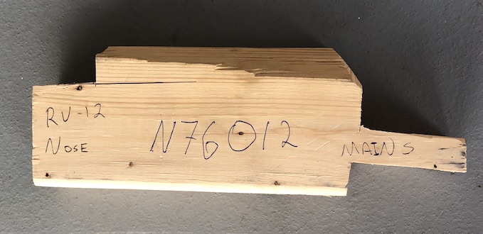

I made a wooden "go/no-go" gauge for my planes.
  • Take the pants off
  • lower the pressure to the minimum that you will tolerate flying.
  • Put the pants back on.
  • Take a scrap of wood and make a notch on one side.
  • File the notch until it just barely passes under the wheel pant.
  • Repeat with a different notch (if needed) for nose wheel.
  • Remove pants
  • Re-inflate to desired max pressure
  • Re-install pants.
Preflight check now consists of putting the gauge against the tire. If the wheel pant prevents you from doing so, you are too low to go.
(Ignore the notch below the Mains side of the RV-12 tool).
