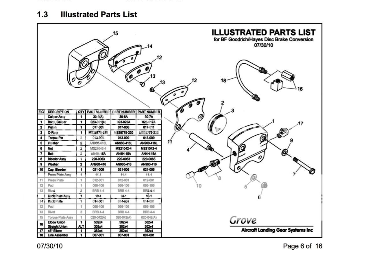

Since Grove is close to Matco design I have a question to the experts. Do pressure plates (11) and torque pins (4) wear out?
