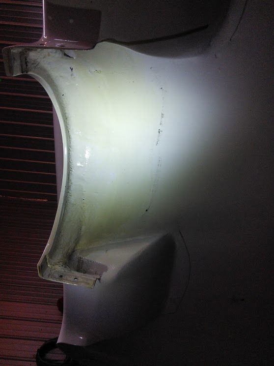

yep, the Kerosene burns brightly. I must admit I'm timid about doing but I will give it a try.

If it is on the back side of the ring gear and inside the lip on that side it would tend to be a front crank seal. if it were on the front side of the ring gear hub then it would point to a prop leak. Sorry about the bad news, you can do it.

Originally Posted by sbalmos View Post
I couldn't remember if you had a CS prop or not. I'm betting prop seal, based on how it was able to pool on the edge of the air intake of the cowl. Crank front seal is too far back, but was the only idea if the prop was FP.
the oil is a significant distance from the front edge of the top cowl. it seems the oil travels fwd and out between the cowl and spinner but I didn't have any oil on the windshield but I did see some on the top side of the cowl at the fwd edge. the dipstick measured 7 qts. so plenty of oil remaining.

I went through months and months of searching for an oil leak. Oil was everywhere but I was "sure" it was the crankshaft oil seal. So I "diapered" the area with some kraft paper that fit around the crankshaft and ran the engine. No oil found. But I removed the (fixed pitch) prop and changed the crankshaft oil seal anyway. Changing the seal wasn't that difficult (My engine uses a split seal). I still had the oil leak so I added some of that fluorescent dye to the engine oil and used an UV flashlight to look for leaks. After hours and hours, I couldn't find any indications.
To make a long story longer, I eventually found some fluorescent dye on the cowling below cylinder #2. The leak turned out to be at the rocker cover gasket but the air flow in the cowling pulled it up front by the ring gear.

There seems to be more oil on the floor than could drool down from the cowl. Meaning maybe like something that contains oil is leaking. If that much oil was simply splattered around on the cowl, the belly would have been covered, I'd think.
