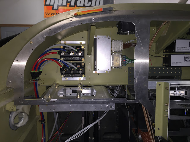

ADHRS1 and 2 on the left, Transponder mounted between the subpanel and panel support frame, EIS to the right of the ADHRS.
TCW Backup batteries (one for critical avionics, one for LSE ignition), forest of tabs, GTR-20 com and VPX Pro mounted between subpanel and panel support frame. The only thing behind the subpanel are the ARINC interface box (Behind the forest of tabs, you can see the mounting bolts), and the LSE boxes, mounted on rails between the subpanel and firewall support angles.
The only thing I wish I could have worked out better is the transponder mount. It's a pain to remove the transponder if I had to. I just ran out of space, and wanted to keep it under the panel vs in the tailcone for balance purposes.

Hey Ed,
I was looking to copy your mounting angle solution for the VPX, but when I went to check my aerosport 310 aluminum frame it looks like it's offset and a centimeter or two higher than the matching flange on the subpanel that you've connected to.
How did you span the gap here? Did you just add something to fill the offset off of the subpanel flange? The method looks great, just want to do the right thing here.
Thanks!

No compensation needed. I just ran an angle from the bottom flange of the subpanel to the bottom flange of the aerosport aluminum support. I don't know if it's exactly level or not, but it doesn't matter.
