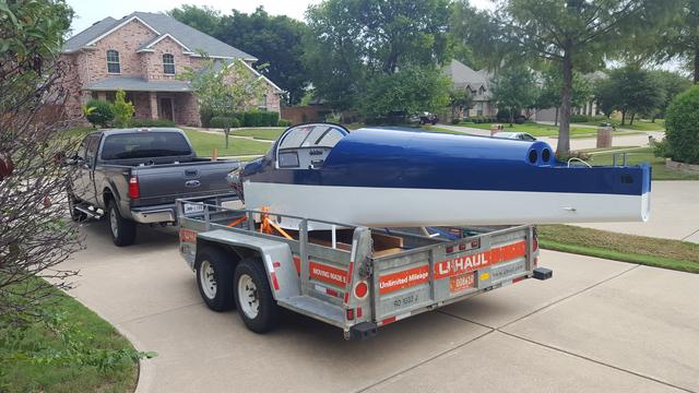

This past Friday I started my move to the airport. I am taking parts as I finish the paint (need to get them out of the way to make room). I started with the fuselage since it was residing in the paint booth (no other place for it to go).
Since it came off the assembly fixture, the fuselage has been living on a rolling cart I built. It carries the weight at the firewall and the main-spar. I put a padded support under the tail when working just in case I shift the CG aft...don't want it to fall on the tail.
For the move I kept it on the cart. I used a wood blank bolted in place of the main spar as a tie-down point, along with the engine mount.
I made a very slow drive from east Plano to Aerocountry. I'm sure the other traffic appreciated me going 25-30 in a 45. That is why went during light traffic.
My wife was able to help me load it, but had to stay to get the kids from school. Offloading by myself was exciting to say the least, but the plane and I both survived.

Love your trailer surely beats mine. Wondering how did you manage to stay 35 on a highway

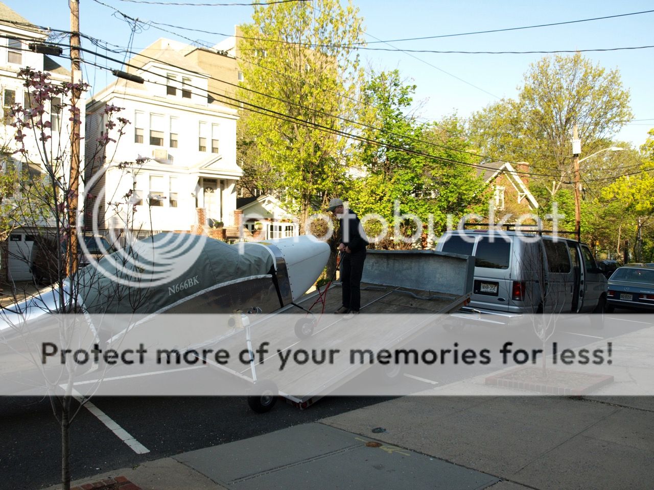

Has anyone ever put an intact RV angled on a trailer and moved it? It would seem that the 24 ft. wingspan could be reduced to around 20 ft by angling it. Picking the roads and traffic times makes it seem like it could be done. It isn't but a few miles.

Paint with the wings and tail off. Easier and you will get a better paint job.

Since I dont have the plane on the gear, i had more trailer options. Didnt have to accomodate that wide gear track.

Keep your speed up and you can fly it like a kite.
In reality, it is pretty easy to just install the wings after paint. There it no big upside to painting them installed
