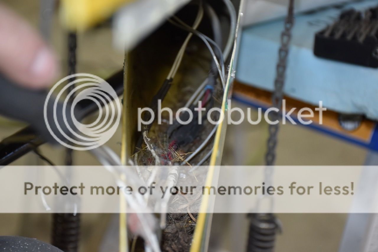

Old 05-06-2018, 06:25 PM
Posts: 7,537
Originally Posted by goatflieg View Post
Any photos, details or suggestions would be appreciated.
Sorry couldn't resist Martin don't do it this way. It attracts mice.
As seen on a recently purchased RV the new owner wasn't happy.
Old 05-07-2018, 05:48 AM
Bob Martin's Avatar
Bob Martin Bob Martin is offline
Location: Richmond, Virginia
Posts: 1,114
Default WOW
Have to admit......I did not like seeing this! As my rudder bottom is riveted on. Good thing I have a hangar!! Vans instructions say drill a hole in lowest point for water drainage, but maybe should add hardware cloth for bird screen.....

Old 05-07-2018, 06:01 AM
goatflieg's Avatar
Join Date: Jul 2013
Location: Clarkston, MI
Posts: 422
I guess so! I did put screens up on my NACA intakes... but didn't think about the rudder bottom. Maybe a plug with a REMOVE BEFORE FLIGHT banner is in order. When I think of all the cracks and crevices a plane has that critters & bugs can get into, it haunts me.
Right now our area is having a large infestation of stink bugs and they've been invading the garage/shop. At least, as bugs go, they're pretty benign. I have my property maintained by a pest control company, and they die after getting in... but man, they're everywhere. I'm always vacuuming them up. Unfortunately we can't hermetically seal our aircraft, so we do what we can and be vigilant. Probably the best thing is to keep the plane active, and hangared when it's not.
