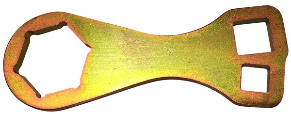

This is what I use. No punching holes, no bags, no mess whatsoever. I have a papertowel standing by to wipe up any drips off hoses, etc.
I also use the Anit-Splat Aero Oil filer wrench - highly recommend it as well.
