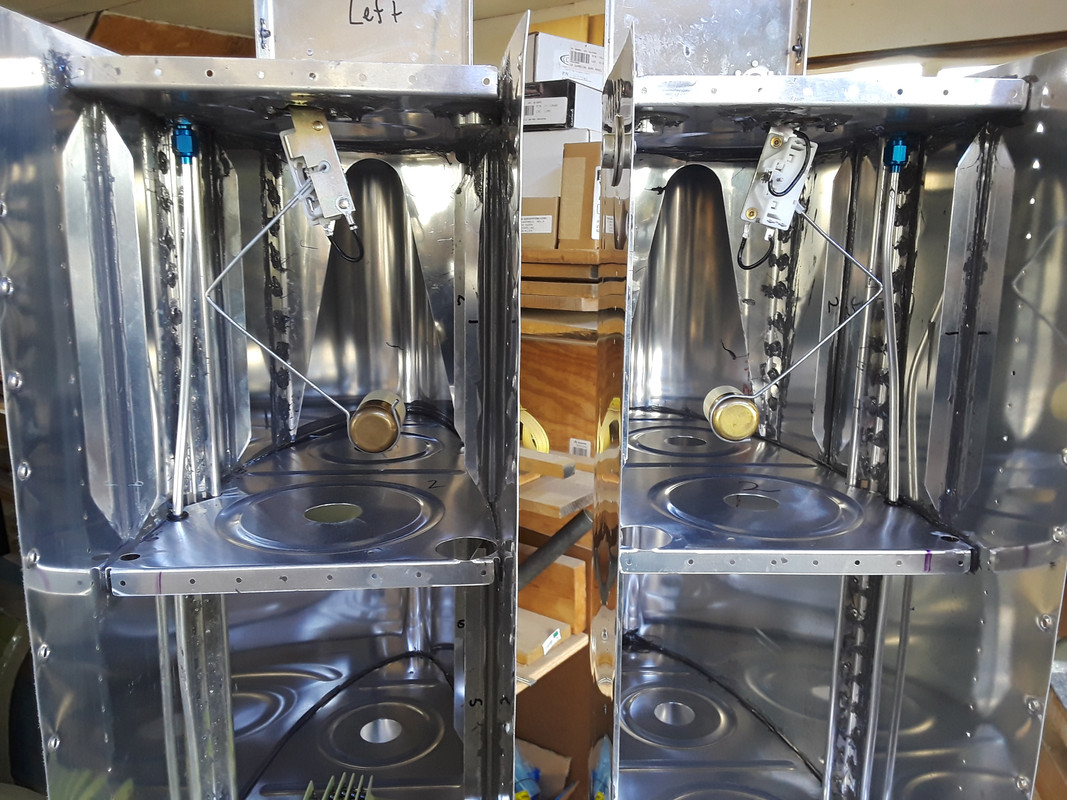

A little heat with a heat gun and a stiff 1" wide putty knife with a sharpened edge works very well. I popped mine off with very little effort extending my fuel tank capacity on my -9 quick build wings. Aircraft paint stripper works great to clean up the remainder. There is no need to purchase the expensive stuff when a can of this stuff works as good, or better. https://www.amazon.com/Klean-Strip-Q...+paint+remover
[IMG]DSC02040 by David C, on Flickr[/IMG]

I just constructed my tanks. When bending the sending units I needed to bend the float to clear both the J channel and vent tube. Slightly forward or aft the float would stick against one of the two.
Perhaps you don't need a new unit, just a slight adjustment of the bend. I agree, a little careful heat from a heat gun should soften the sealant.

Some one mentioned the sending unit getting hung up on internal parts. This jogged my memory. After installing the sending unit, I checked it by connecting an ohm meter and turning the wing over. I had an issue on at least one wing with the sending unit getting hung up an had to remove it and bend the float wire. This may be what is causing the hang up now.

When I built my first set of tanks, I missed the step in the drawings that require a very small bend in the portion of the float arm that goes into the portion of the sender that rotates. When calibrating the tank I found my floats would flop all around, thus had to take them off to redo it.
It's a bit of work, but it's a lot faster than removing the tanks completely. As noted before, you should be able to remove the screws and then use a putty knife sharpened and some elbow grease to let you pry off the sender.
In my case, in putting the sender back in on one of the wings I got a small dab of proseal on the cork (and didn't realize it), and after a few days found my float was stuck to the bottom of the inside of the tank. Dreading doing the whole thing over again, I was able to rig a long piece of hinge pin with a little bit of flare to the end to get in via the fuel drain and be able to push up and down on the float arm, and eventually dislodge it. If yours is "sticking", you may be able to do something similar as well.
