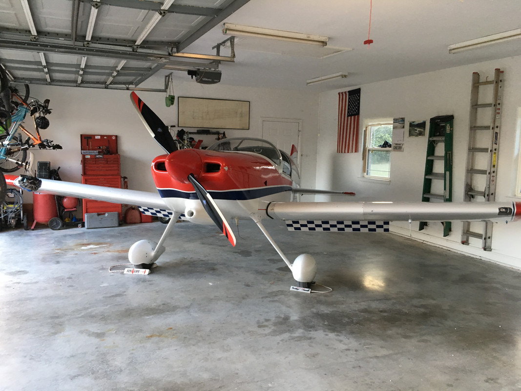

I put my down payment on a 3 blade nickle edge Catto at Oshkosh 2018. The prop was delivered November 2018 (Its a WORK OF ART!) but it had the wrong prop bolt size holes. I needed to work with them and ended up having a local machine shop ream them to the proper size. A week later, I then installed it on my 160HP RV-4 and flew it and found that I could easily spin it up to 3000RPM only getting about 160kts TAS in level flight. After a month or so of experimentation, Nicole at Catto quickly added me to the queue for another higher pitched prop. They said that it would take a few months.
Fast forward to Oshkosh 2019. Cleaning the plane the week before flying up still waiting on the new pitched prop, I found this:
This is the "cracking of the nickel" that people here have discussed.
Would you believe that Nicole and Craig 2 day shipped me a loaner prop to get me to Oshkosh!? I was so happy. I took delivery of the final pitched prop 3 weeks ago (10/31/19 about one year after receiving the original prop). Below are the pictures and some numbers including the final pitch. I see right around 170kts TAS at 2750 RPM above 7,500DA. I also still get 1,200-1,500fpm climb solo and last week i was going in and out of a 1,700ft strip at max gross no issues at all what so ever!
Its a fantastic prop, and the Catto family will take care of you, you just need to be patient while they work to design you the best prop that they can.
