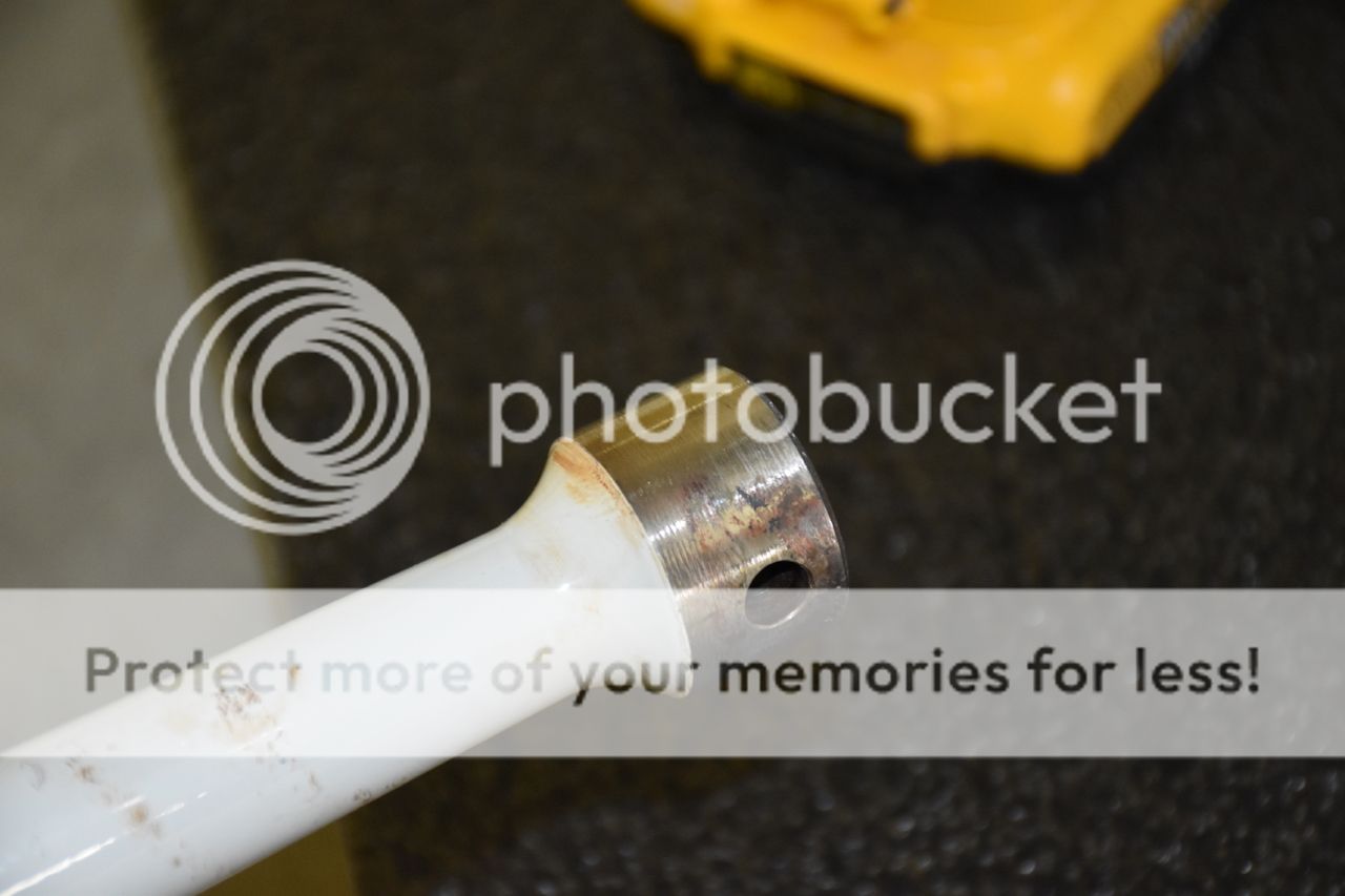

Short story long that's how the stock nose wheel gear bolt looks after 6 years of constant abuse. RV9A with over 3,000 of flying hours and 4,200+ landings some of them at places I wouldn't even think of going second time. No modifications to the gear whatsoever all stock.
Replaced with the same AN5-20A bolt per plans added an extra thin washer and used red Locktite on threads. Surprisingly there was no play after cleaning out the hole in the engine mount and the gear leg. Snug fit. If anybody has an ability to analyze the old bolt I would gladly mail it. It would be interesting to know how fatigued the bolt is and how far it is from the failure.

Vlad - did you do the loctite mod to the gear leg itself to keep the leg tight and imobilized in the socket, or is your nose gear on your 9A totally stock per plans?

Totally stock per plans Bruce. I locktited the bolt threads only.

Thanks for posting that, Vlad. It's the one part I'm most paranoid about...I'm checking the bolt every 25 hours for tightness and any sign of movement.

Looks like a bit of Russian dirt there ... shouldn't hurt a thing!
Bolt actually looks pretty good; it would be interesting to see if a pull test showed any significant weakening.
