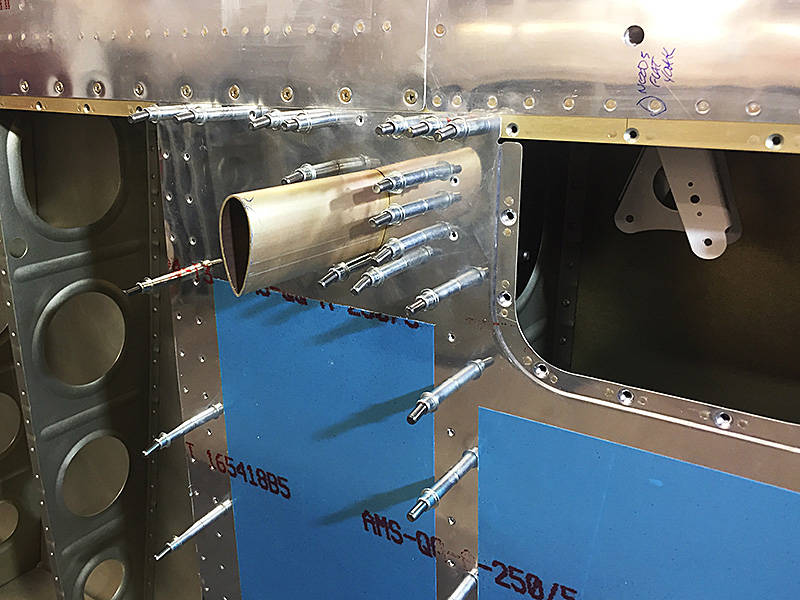

I sent a similar question to Van's when I was drilling my ribs and they basically said follow the FAQ and the holes you get should be enough. So I chose not to drill another set of holes. I plan to make due with opening up only the existing tooling holes.
Old 11-06-2017, 12:53 PM
mfleming's Avatar
mfleming mfleming is offline
Join Date: Sep 2016
Location: Joseph, Oregon
Posts: 177
Thumbs up Good to Drill
So I received a email from Vans today. The photo they commented on was the post #1 photo shown below.
They said "This additional hole will not be a problem."
So...As soon as I get my new step bit, I'm drilling the third hole
The ½" center hole will have my 14AWG heated pitot wires and the two ⅜" outside holes will have the pitot and AoA tubing. This way, I don't have to exit the conduit wth any wires or tubing on the way to the wing tip. And on the right wing, I can run my A/P servo cable through the ½" hole and all the wing tip light wires in the conduit.

Michael thanks for updating this, this will be nice for future people to see a response from Van's on this topic.
Also, thanks for the good pics, it helps big time when discussing things!
