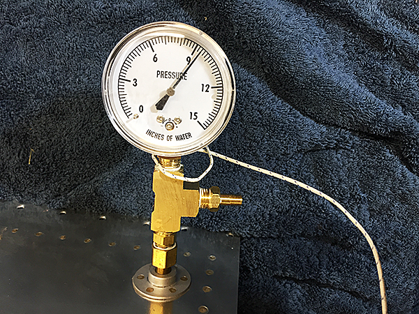

Initial test of the left fuel tank has passed.
The Float access plate was tested with the cork gasket installed. Now that the initial test was a success, I'll pull the plate, remove the cork gasket, pro seal up the plate, reinstall and retest.
The multimeter is measuring ambient temperature for a reference as I recorded pressures during the test.
During the test I used a leak test fluid to check all the seams and rivets.

Van's and Synergy recommend eliminating the cork gasket and just using sealer now.

Completed my initial leak check on my second tank today...Passed.
Tomorrow I'll seal up the end plates, let them cure for a couple of days and then do a final leak check on the tanks.
Using leak detection fluid to track down any leaks.
Did Van's post anything publicly to that effect? I'm getting close to closing my tanks up and am still going back and forth on "cork + Permatex" vs "cork + Proseal" vs. just Proseal.

When i took the factory tour, the guy there told me to toss the cork gasket as far as i could!!
