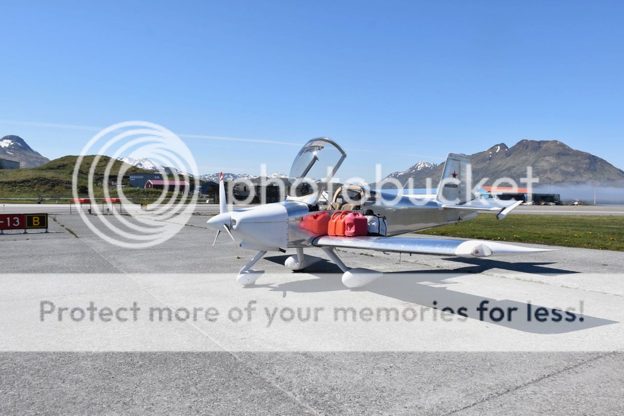

Steve,
Reporting from Dutch Harbor with the first 100 hours on the flap fairings. Somebody even asked me what type of flap actuators I had.
Tell Amanda I will be contacting her in couple years to be an RTW sponsor hoping her business will increase multifold. Good job on those fairings thank you! Sleek, functional, good looking. There is a speed increase having them. Did I mention they distract the lookers from my rusty bottom skins.
Where is N666BK?

good to hear. I'll tell Amanda. we discuss you photo's over the dinner table and imagine your adventures. I have similar flight hours on my flap fairings but you will soon zoom past me.
