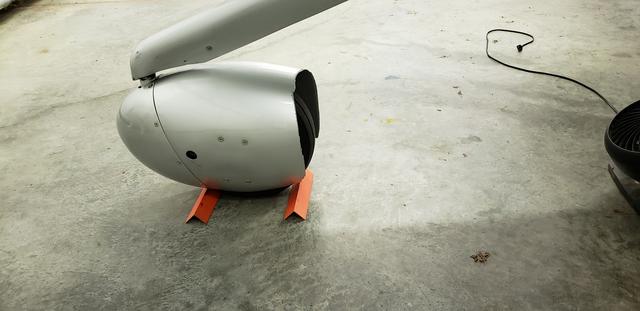

Exact same thing happened to the guy who bought my RV-10. Considering my caution to him on his landing technique was ignored, I did not find this surprising.

Is it just me who thinks those breaks seem awfully straight, like maybe along a fiberglass layup line or something? I'm surprised that it was that defined.

Nose wheel shimmy can be a very violent event. It is very similar to control surface flutter and as shown, can do damage to a wheel pant or nose gear assembly in the same way.
I have not looked at the production drawing for the aft portion of the wheel pant, but I would not be surprised if there isn't a reduction in layup thickness in the vicinity of the failure line shown in the photos.
That does not mean that the wheel pant is badly designed.... it just means that like everything else on the airplane it is designed to specific limits that would never be exceeded as long as everything is maintained properly, and the airplane is operated inside of the limits of normal operations,

Isnít there a bulkhead just aft of that break?

I found a potential reason why it broke, shimmy was the cause but at least a contributing factor to the failure might have been that the brackets were not between the washers 062 25783054 and the fork.
So lesson learned when you mount the rear nose wheel fairing make sure its captured in between the nosewheel fork and the washers 062 25783054.

Was the bracket not captured, or did it pull out with the shimmy? I assume if it puled out, the nut/bolt would be loose.
