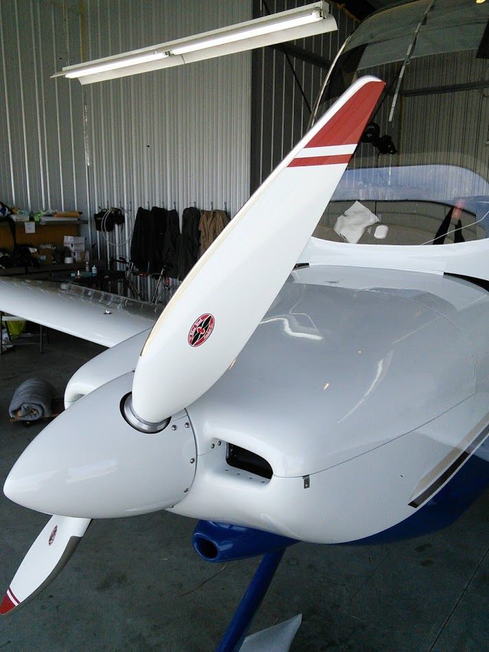

Old 05-28-2018, 06:26 PM
Posts: 1,741
Default 650 hrs looks like new
I like this prop.
