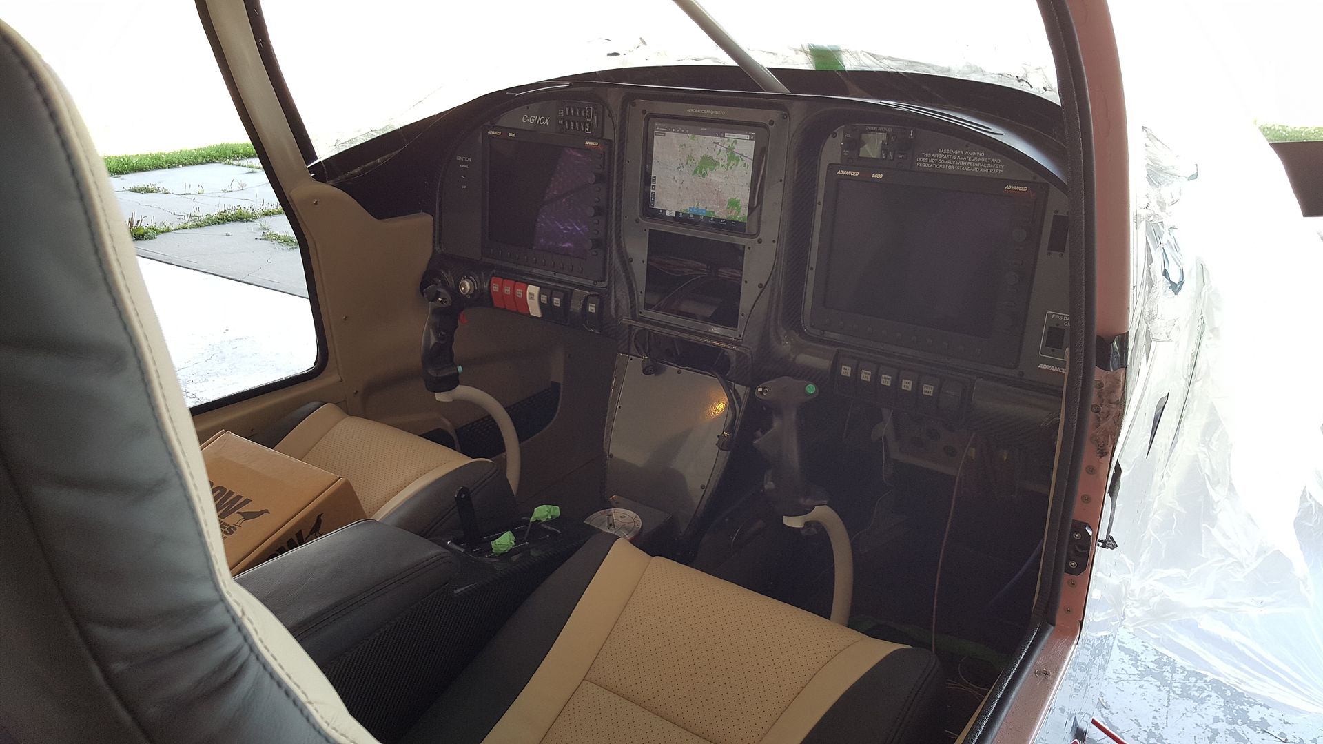

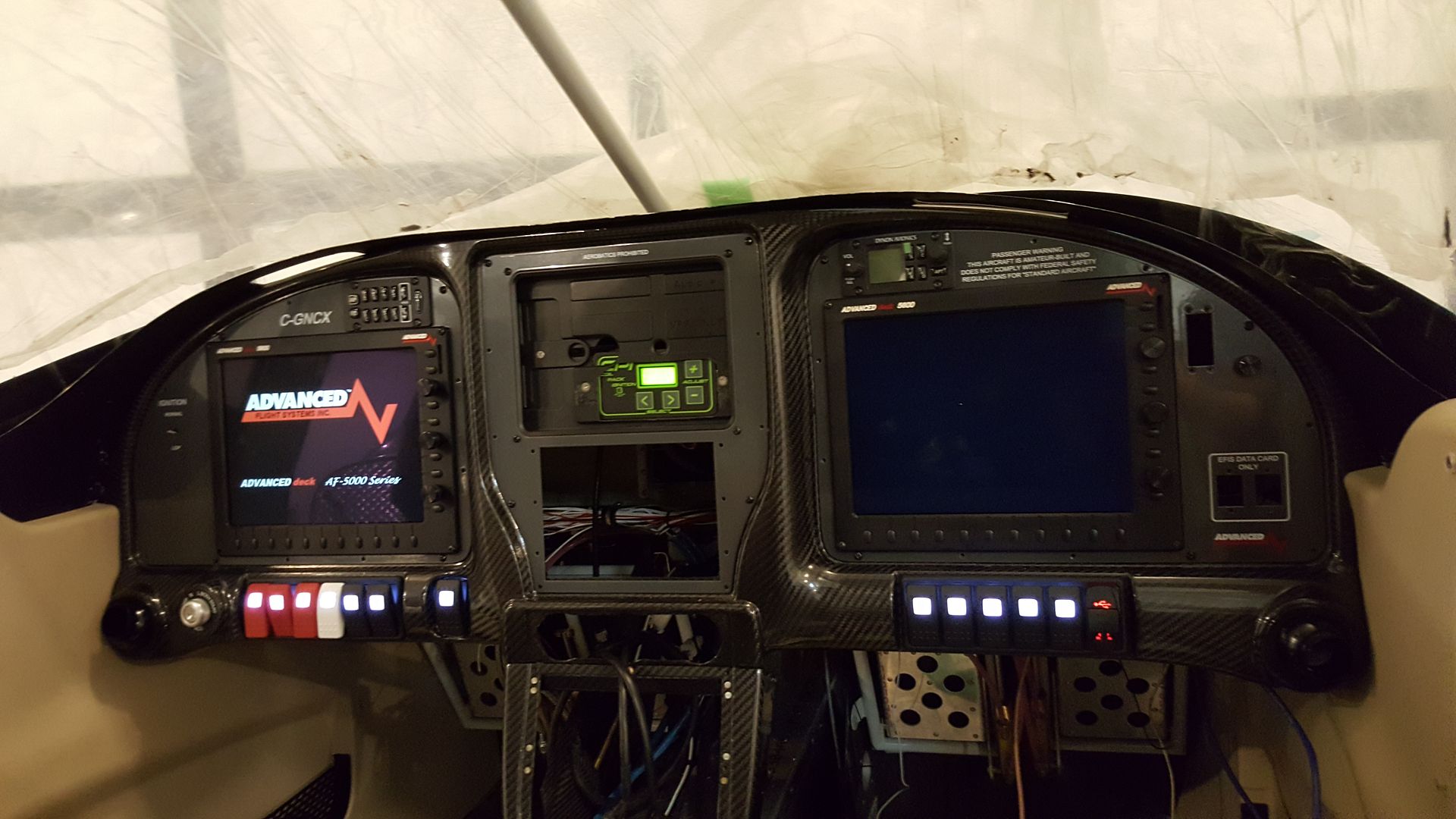

Default Hidden CPI control box
I hid mine away. The new Guardian Avionics iPad mini dock is mounted in the center of my panel. It took a little effort to carefully hack up the mount but it turned out decent.
Once everything is set up I don't think I will need to see the CPI box on a regular basis but it's really easy to access should the need arise.
The timing has not been set with the light yet but everything works well during my ground runs so far.

Your installation looks great. Its cool to see the innovative ways people are mounting the CPI boxes as this system gains momentum.
It appears that you are not flying yet and I assume that you will set the magnet position before you do, but I wanted to address your quote above for the benefit of the group.
With the CPI it is possible to get the engine to fire "right out of the box", then tune it to a buttery smooth idle with a few presses of the advance/retard keys without setting the magnet position. This is fine if you just want a quick ops check and doing so does not hurt a thing. HOWEVER! Without setting the magnet position accurately, you have no reference basis to adjust timing in flight. The timing values shown on the screen will be completely meaningless and could be off by 10's of degrees.
The magnet position takes only seconds to set (making and mounting the timing pointer is the toughest part), and only has to be done once. Is is the mechanical relationship between the magnets you installed and the position of the hall sensor, and is unique to your engine. Once established, you write the number in the logs and should never need to touch it again.
So the bottom line is simple: DONT FLY WITHOUT SETTING MAG POSITION! Tuning idle "by ear" is fine, but not on takeoff roll.

This information is imperative for safe flight. Today I used the timing light and the MAG POS was set to 91 from the factory setting of 80. As Toolbuilder said the timing could be off by 10s of degrees and still be buttery smooth. In fact, there was no noticeable difference at 1000 to 1200 rpm between the factory setting and the tuned setting. 11 degrees can make a significant difference at higher power settings.
