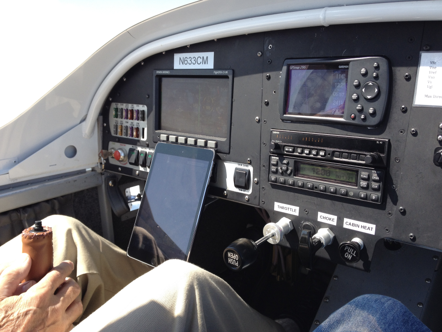

I have D-180 but I believe Skyview will allow same mounting. I’m able to cover up some of the INOP panel switches not being used – no lights or AP. Heavy gage aluminum angle bracket is attached to bottom of instrument bay with Velcro and a single T-nut. A plastic shell salvaged from a cheap iPad carrying case is fastened to the aluminum angle with double-sided tape. The mini iPad pops in/out of the plastic shell just like a Ram mount. I have USB charger receptacle in place of the cigarette lighter and run a 1-meter cable along the floor, up thru the stick boot, and attach to the iPad with quick magnetic disconnect. If you happen to bump the wire getting in/out of the plane it simply falls off instead of ruining the iPad charging port.
I love this setup – viewing angle is perfect even in bright sunlight.

This pic was first build. I have correct 9.7" EZ-roller mount now. My pic was to prove in direct sunlight flying, it works very well.
