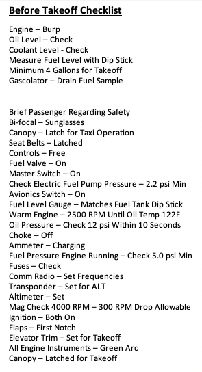

I made a laminated Before Takeoff Checklist that I use religiously. Haven't done anything too stupid yet...
