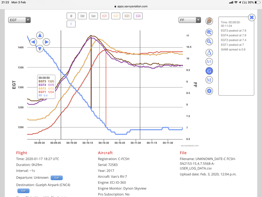

Thanks for the help guys. I contacted Don at Airflow performance, he recommended four new injector nozzles of differing sizes based on my Gami data.
I installed them last night and went flying. Took less than 10 minutes and $112.
The results are exactly what I wanted. All cylinders balanced and peaking at the same flow. I’m able to in 50 to 100 lean of peak smoothly and balanced. GAMI spread 0.1.
BEFORE
AFTER

I went with 0.024” on cylinders 3 and 4,
0.023” on cylinder 1 and 0.0235” on cylinder 2.
Stock injector size is 0.028” so I enrichened the servo mixture slightly to Ensure I get adequate flow on take off. It seems to work as I get 17.0 gph on take off and a 50 rpm rise when aggressively leaning at 1000 rpm ground idle.
